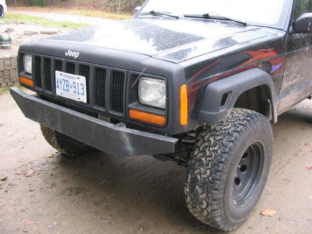

    stock with ends cut off, el cheapo's from C Tire.

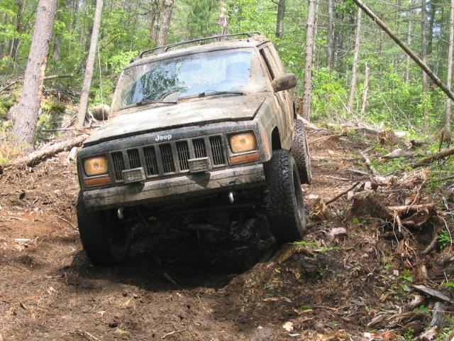

    but that wasn't cutting it, so needed new, tough, and cheap. so I bought this off a good buddy a few years ago. C channel, frame tie ins, offered protection and was not stock.

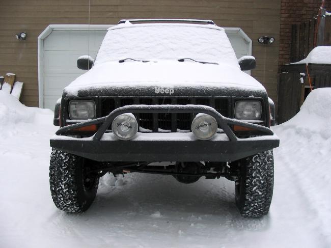

    this light bar got the lights off the bumper and set back so they were protected a bit...
    but I wanted a proper tube to keeps things away from them, $500 would be hard to explain to the wife a second time around. I also cut some off the bottom, angled it back and added some side protection, much prettier looking... still no recovery.

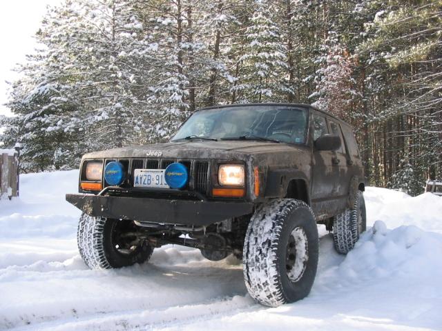

    finally got the shackle mounts on, and thanks to Duncan cleared some room for a 10k Titan Winch
    the winch is mounted to a plate welded to the frame tie ins and bolted to the front crossmember too, plenty strong as tested this past weekend thanks to letting a buddy drive for 5 minutes.
