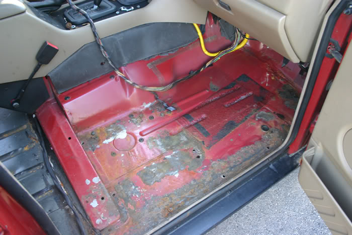

    Its pretty much been sitting since then as the original plan was for it to get on the road by summer but I had to get the money together to do so before I could start the project. This past weekend I brought it home and started by taking the seats and carpeting out so I could clean-up the carpet and POR-15 the floors. The passenger side was pretty clean but when I got to the driver's side I discovered two very large holes in the floor, one of them had even creeped up and rotted away the base of the A-Pillar as well. This thing had obviously been leaking for years, and its still leaking from under the windshield.

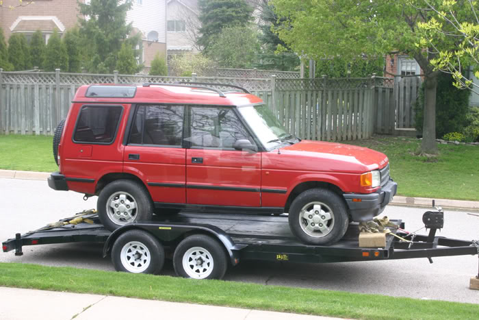

    When I brought it home on Friday from work:

    Floors cleaned up (you can see how big the holes were on the driver's side):
