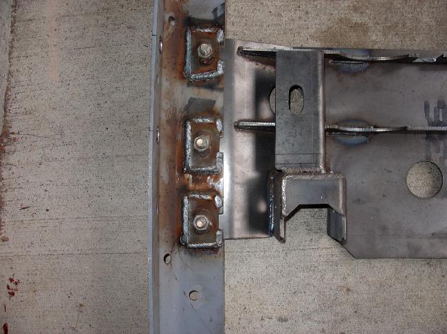

    Anyway, the heep has been on jackstands since Dec or so, waiting for time, money and warm days during the winter (unheated garages suck). Cut the control arm mounts off, then found some of the 'nutserts' for the x-member were spinning, rust seized on or were just crap. So I fixed the frame stiffiners to take some captured Grd8 bolts which were a bit bigger than stock to boot.
    Once the stiffiners were in, I could put the longarms on, but of course I didn't take pics of that.

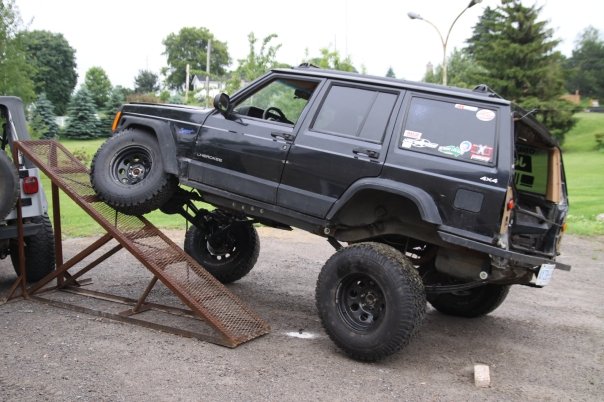

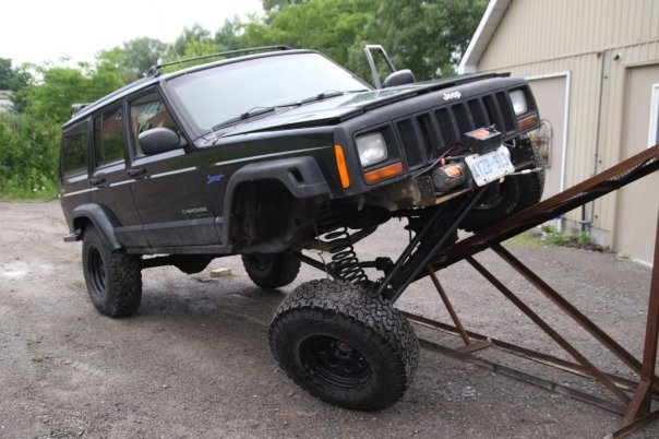

    Now without having a chance to flex it out I wouldn't know what length shocks to get for it... so I brought it over to DirtyPerls to get it on the ramp.
    After all the time and effort it was certainly worth it finally seeing it moving again, and flexing out the long arms once and for all.
    Here's what it did last year after getting the 8.8 put on. No shocks in the rear, OME's up front, they were limiting my droop just a bit.
    Now with the long arms,
